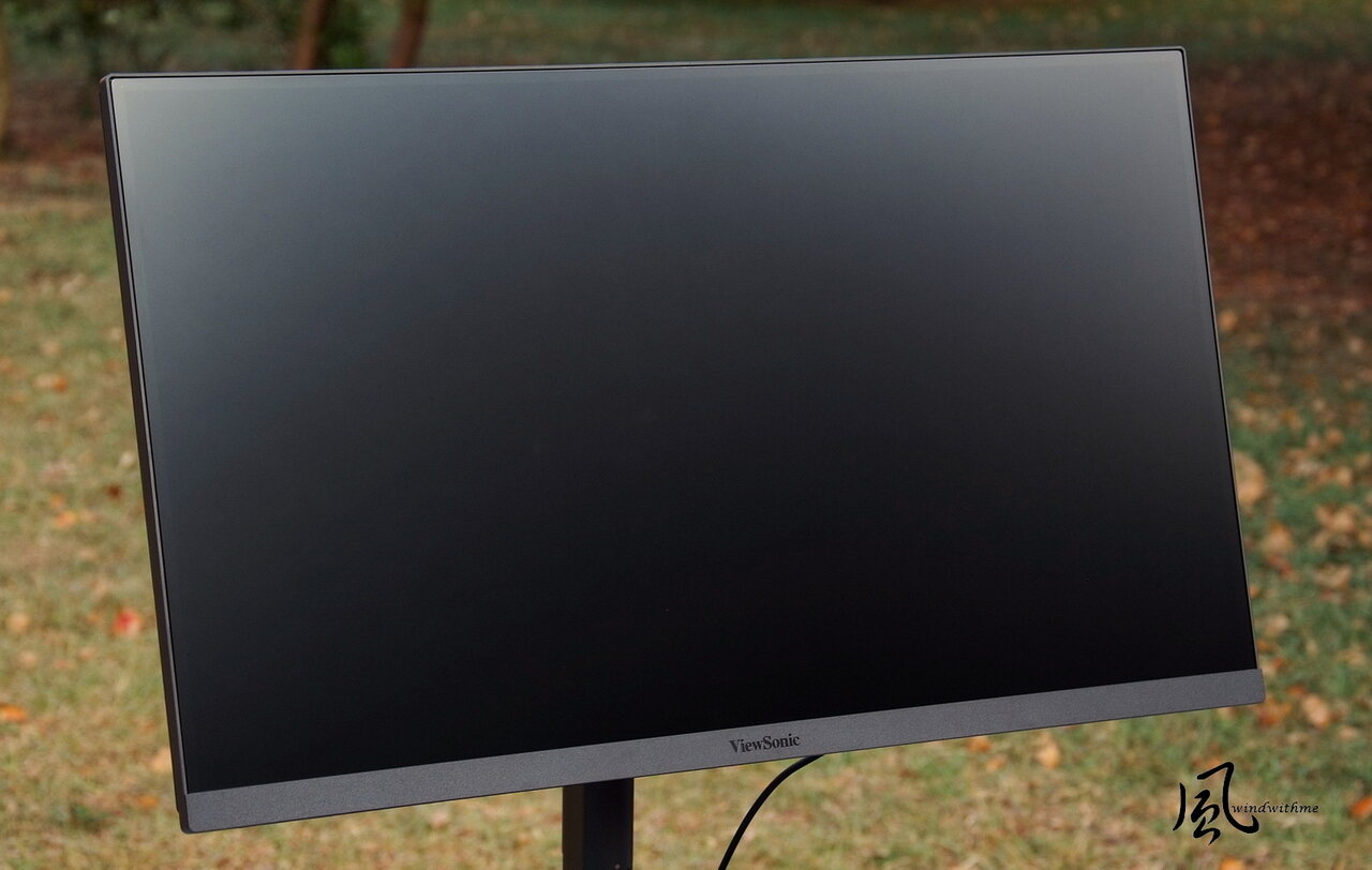

    The VP2776 screen is frameless on three sides, giving it a straightforward appearance and enlarging its appearance, while the panel uses LG’s Nano IPS technology. IPS monitors are pricier and less common in the current market, and Nano IPS panels come embedded with an extra layer of backlighting nanoparticles for a wider and brighter color gamut.VP277602.thumb.JPG.fb7e5036ad06aa34eb8a0053f5a47f63.JPG
    The 27-inch screen has an anti-glare 3H hard coating and 2560x1440 resolution, commonly known as 2K or Quad HD. With a 165Hz refresh rate, it’s G-Sync Compatible and possesses VESA-certified HDR 400, a DCI-P3 95% color gamut, and 400cd/m² luminance. Equipped with flicker-free and anti-blue light technology, it effectively reduces eyestrain during extended periods of use.

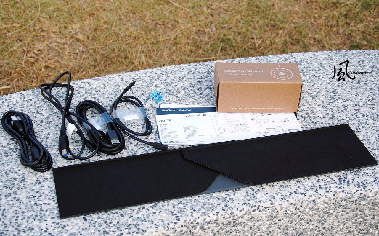

    Accessories include a 3-pin power plug (IEC C13/CEE22), DisplayPort cable (v1.4), USB Type-C cable, USB A/B cable (v3.2), and a quick start manual. Two more accessories included with the VP2776 are rather more special, and this is the first time I’ve seen them included with a high-end professional monitor: a ColorPro color calibrator, and a portable magnetic hood with what can be said to be a professional design.

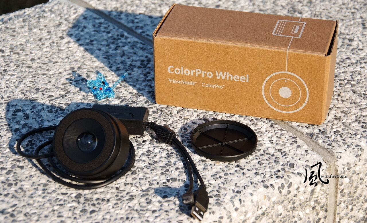

    The ColorPro calibrator comes with a protective cover and appears to have a single lens. Having used a Spyder for more than ten years, I have to say the ColorPro has a genuinely attractive appearance, and unlike other high-end calibrators, software supporting the ColorPro Wheel can immediately make use of its click and spin functionality.VP277605.thumb.JPG.077cde9448132ef8651670414e481aee.JPG

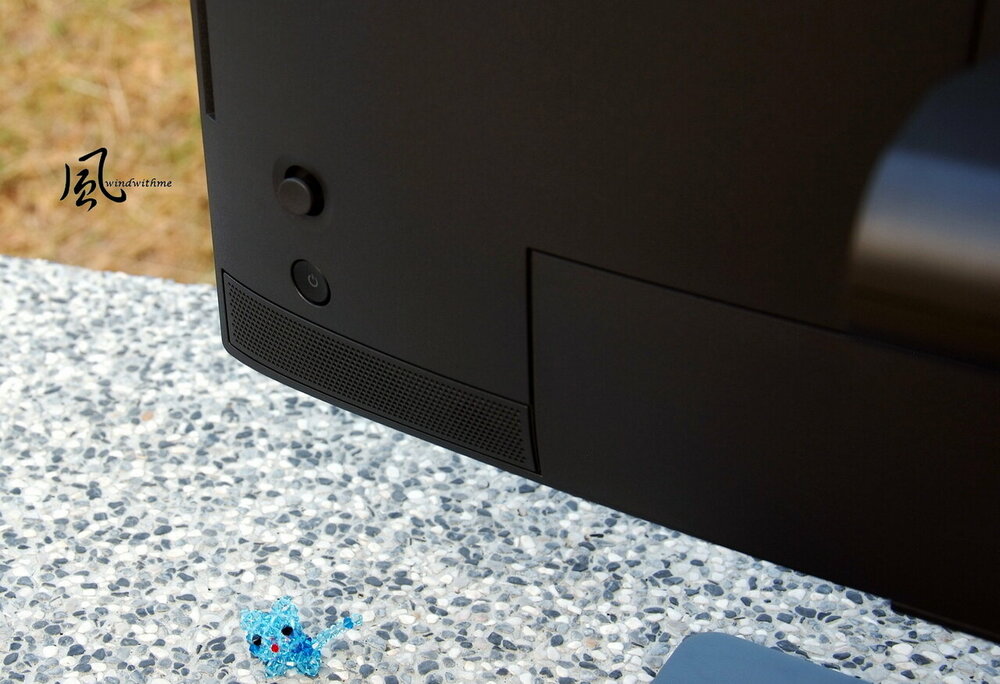

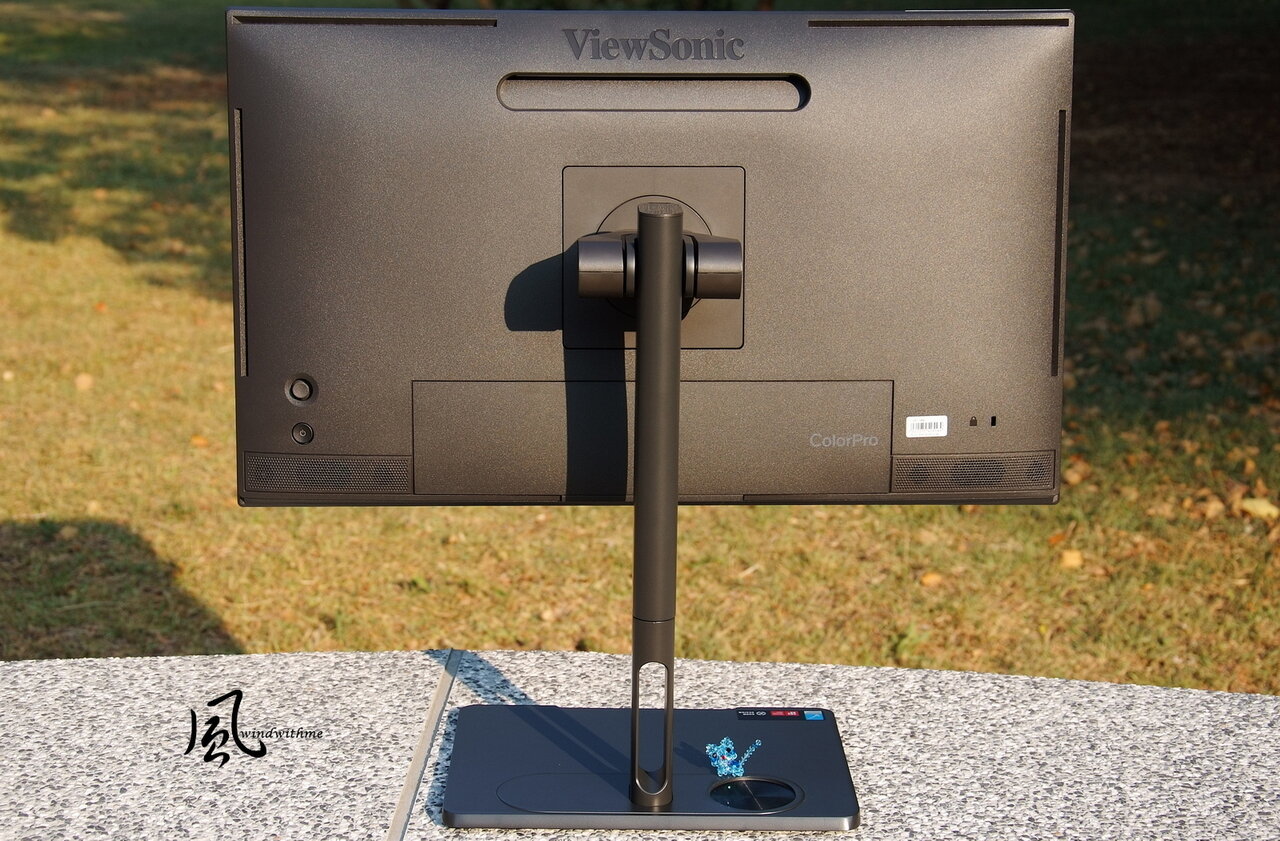

    Looking at the rear of the VP2776, the ViewSonic logo appears at the top, with an illuminating light beneath. The center bracket can be removed to reveal 100 x 100mm holes, convenient for VESA-supported wall mountings. Two 3W loudspeaker holes are located at the bottom left and right. There’s a Kensington lock at the bottom right, and cooling vents are found along the top, left, and right edges.

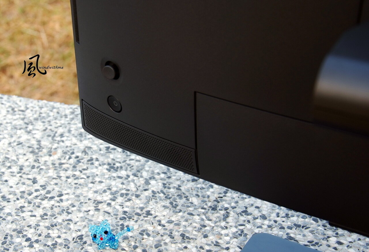

    At the lower left of the rear are a blue-lit power button and a joystick for the OSD. VP277607.thumb.JPG.ff7185353947ffe6d90c1a762d147d17.JPG

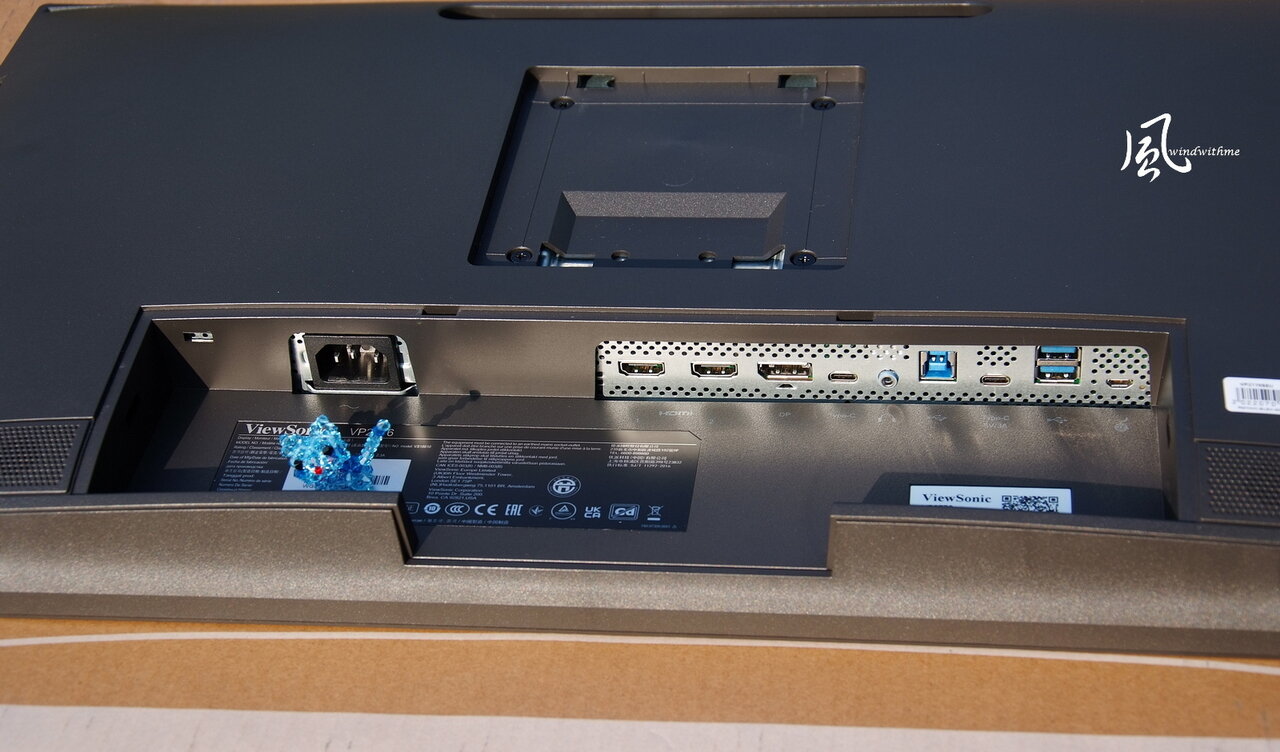

    The ports on the back of the unit include, from left to right: power source, 2x HDMI v2.0, Display Port v1.4, USB Type-C, a 3.5mm audio jack, USB Type-B, USB Type-C (5V/3A), 2x USB Type A, and a Micro USB. USB Type-C can be used to mirror/extend the displays connected, transfer data, and charge devices. Whereas when using HDMI or DisplayPort to transfer audiovisuals, USB Type-B can be connected for data transfer.

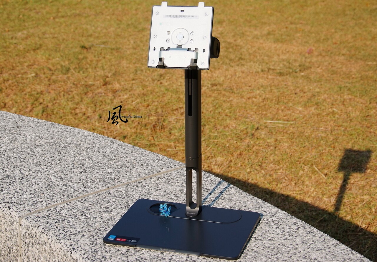

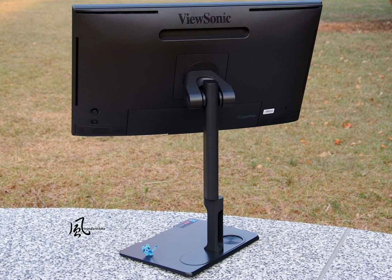

    Personally, I think the design and functionality of a stand and base are very important for creative professionals. As is commonly seen with top-tier monitors, the VP2776’s stand is multifunctional, with a wide scope for making adjustments.
    There are five markings on the center of the stand for making graduated adjustments, and holes underneath for neatly managing and arranging cables.VP277609.thumb.JPG.809cc68d5fb905038d4a294d72448cbe.JPG
    The stand is approximately 130mm tall. It swivels across roughly 120°, pivots 90° clockwise and counterclockwise, and has angles of elevation and depression of 21° and -3°, respectively.VP277610.thumb.JPG.2d138ed378a6c201629f6cbab8d5604d.JPG

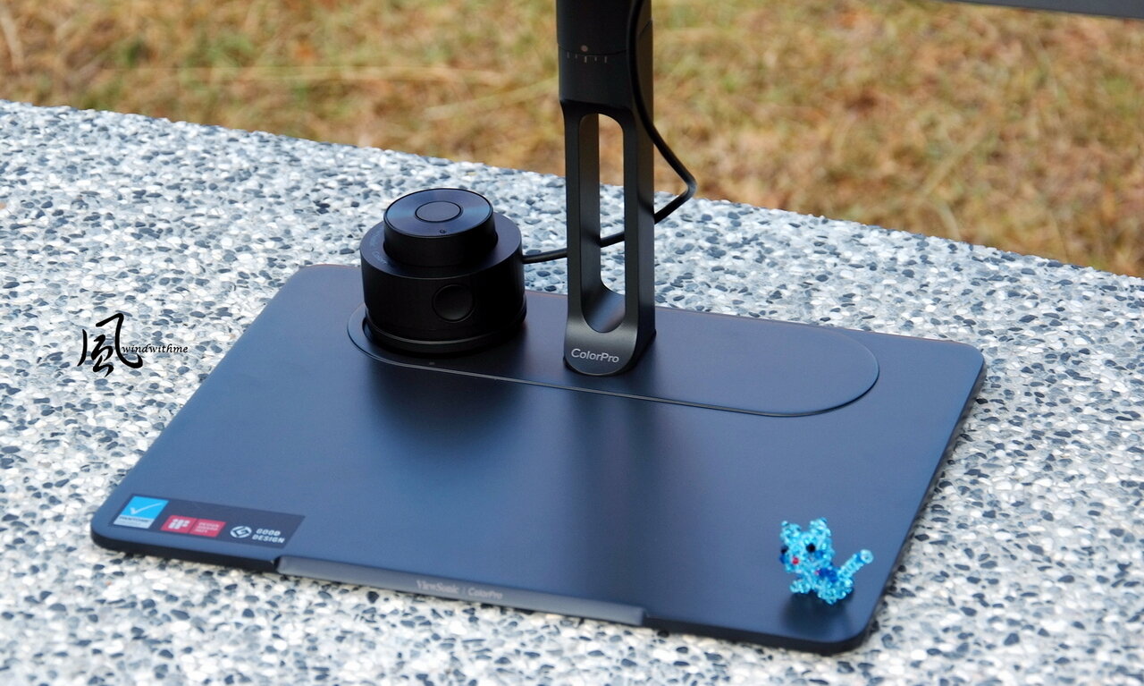

        The base is designed to lie close against the table. There are no bumps or bulges, so objects can conveniently be placed on top of it. At the bottom left is the Pantone certification, as well as indications for the many awards the unit has won, including a 2021 iF Design Award, a 2021 Good Design Award, and a 2021 Wallpaper Award.
        The metallic build lends the base weight and good stability. The monitor weighs about 8.4kg altogether, and the simple design of the VP2776 gives it a high-quality feeling.VP277611.thumb.JPG.677a688b91823ebfe5bb7a13d4123891.JPG

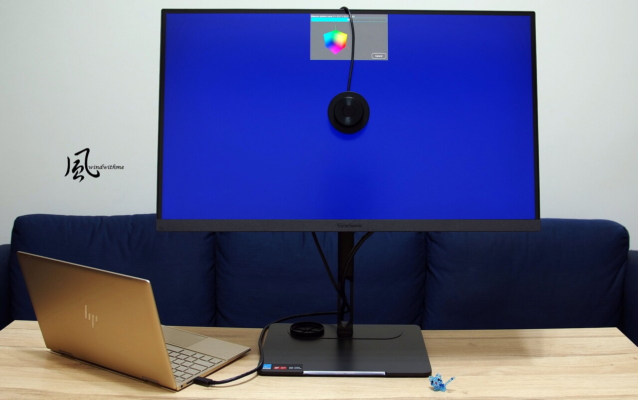

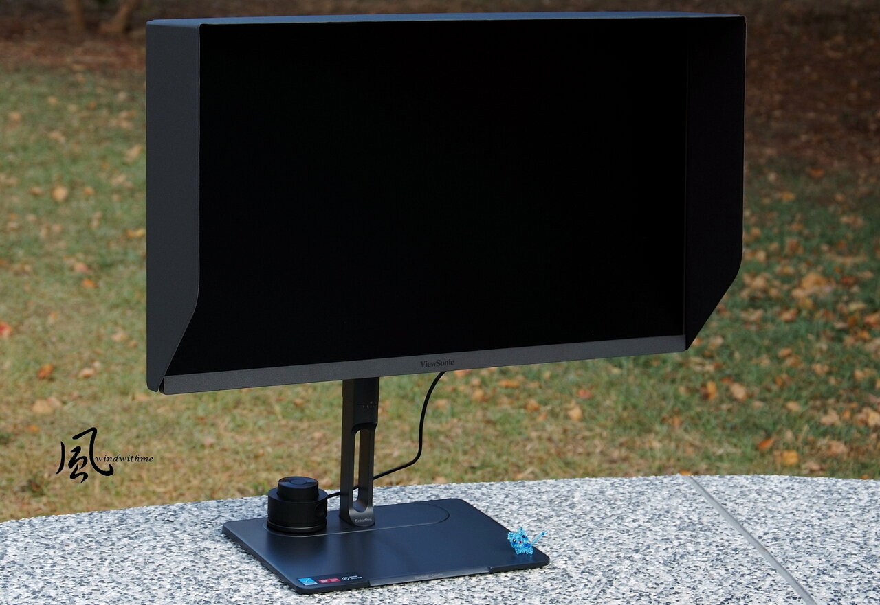

        How it looks with the calibrator and magnetic hood covering installed.VP277612.thumb.JPG.fce5bed36b407dac1b646b0ffe0756c2.JPG

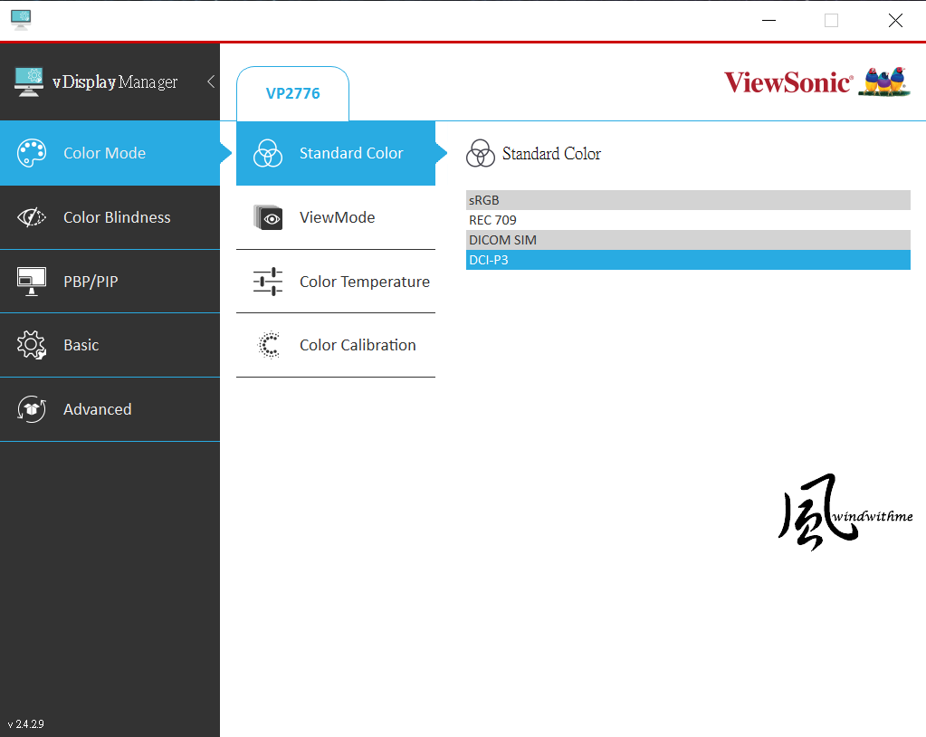

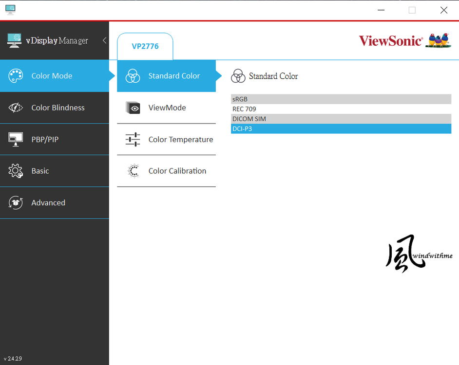

        There are two main software packages included. First, vDisplay Manager: the left-side menu options are Color Mode, Color Blindness, PBP/PIP, Basic, and Advanced. In Color Mode, the Standard Color menu provides four color standards to choose from.VP277613.thumb.png.d5b996285002947b85a840746053c808.png

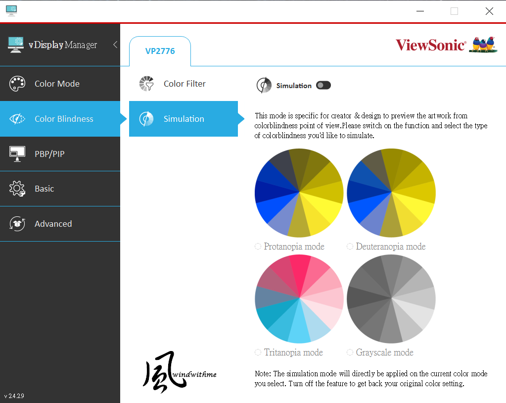

        The Color Blindness menu brings up Color Filter and Simulation. The latter is mainly for simulating and confirming whether your work can be seen clearly by viewers with color vision deficiency. Users with color vision deficiency can use the Color Filter function to see the screen more clearly.VP277614.thumb.png.8584b6da88b71c88edf96042908d63b7.png

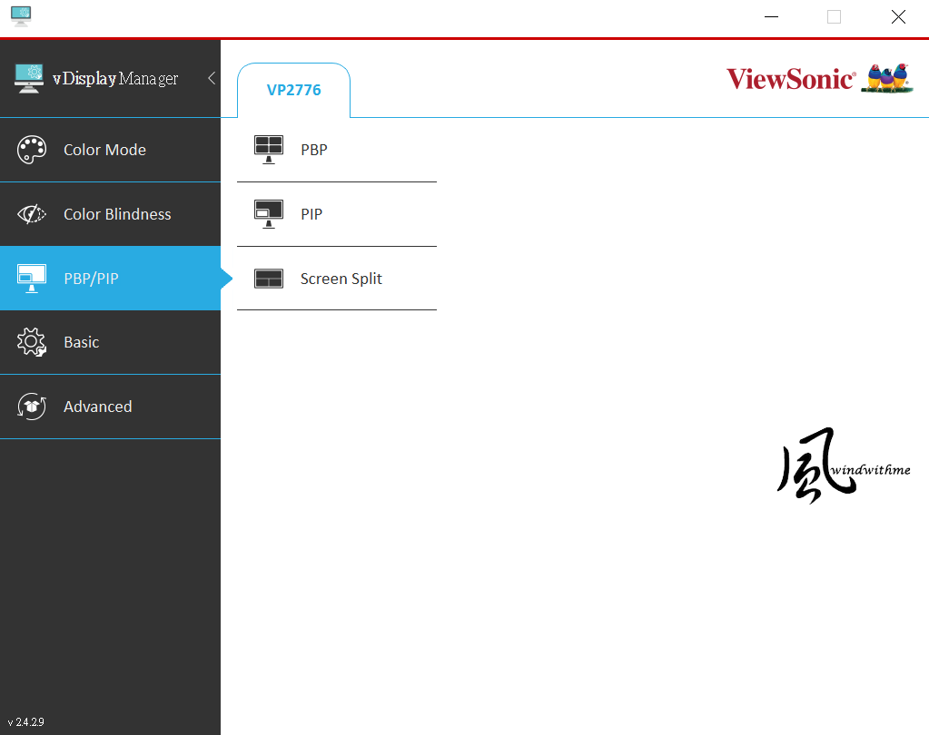

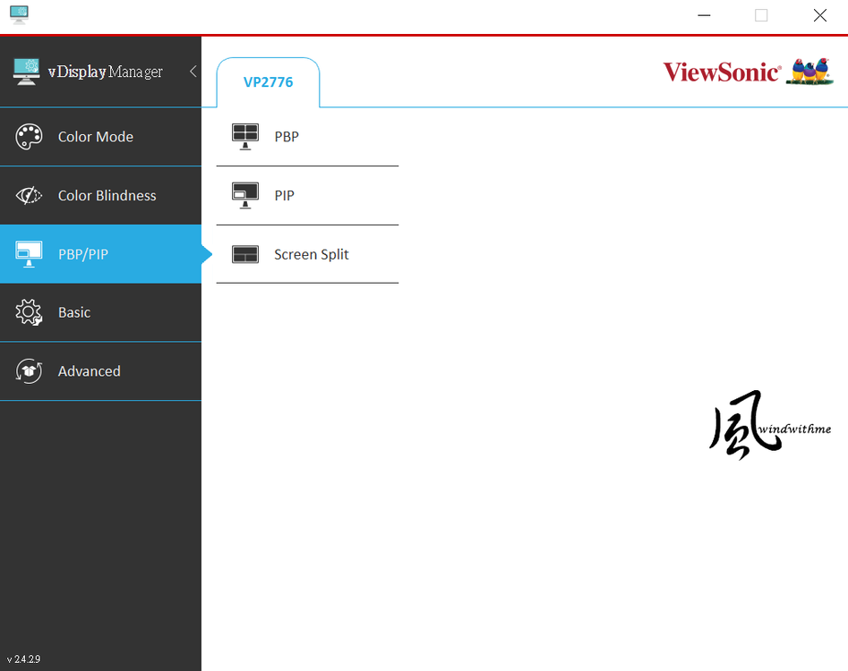

        Picture-in-picture, picture-by-picture, and split screen modes can be found on the PBP/PIP page.VP277615.thumb.png.3dd041e1ae209d3c0eead6ed5d8aa0aa.png

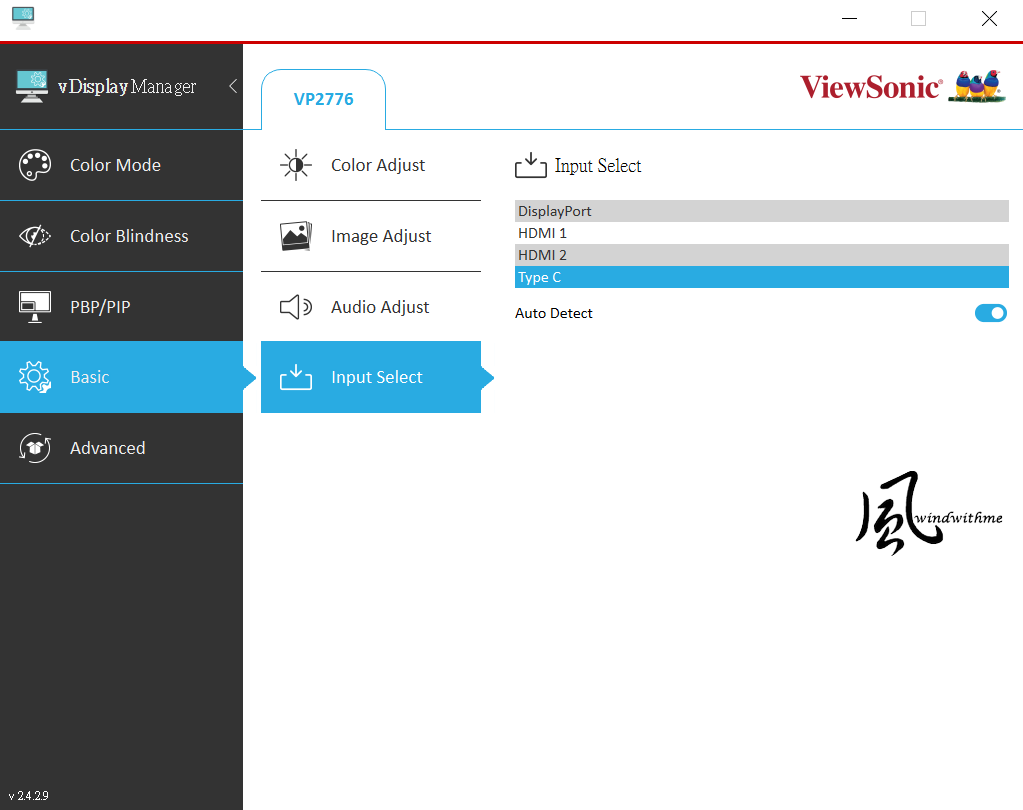

        The Basic page brings up common options like Color, Image, Audio, and Input. Input Select can be used to choose a desired port or to switch ports automatically, which is very useful when frequently cutting between screens. vDisplay Manager’s inbuilt OSD is multifunctional and more convenient than the joystick control on the rear of the unit. Since the color calibrator can be used to control the OSD, after some familiarization it will basically become your go-to interface.VP277616.thumb.png.089bb0717cea82c6b4e8b63519632f9a.png

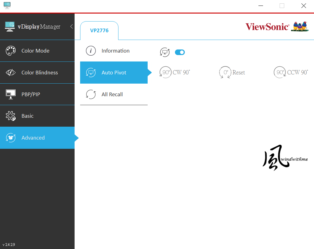

        The Advanced page shows information and options for resetting defaults and rotating the display. When the screen is pivoted to a portrait orientation, the Auto Pivot function will rotate the display accordingly. English and Japanese language options are available, hopefully with more to be added in future.VP277617.thumb.png.cf85e81e0c54721228476c4e397b98ff.png

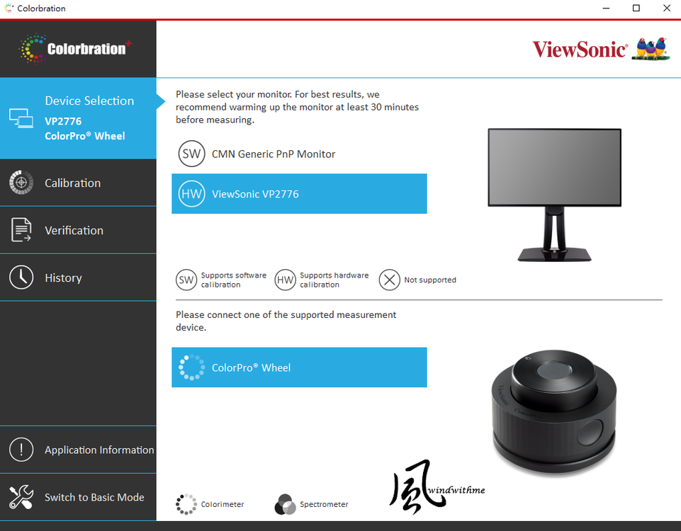

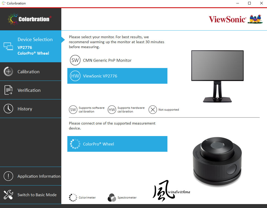

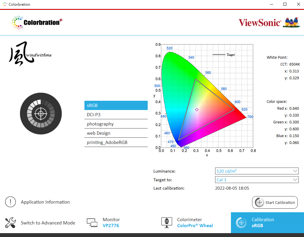

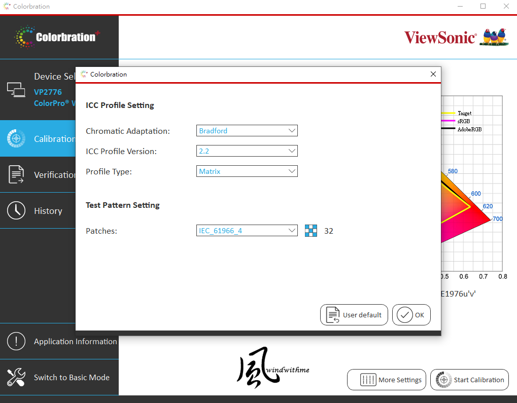

        The other software included is Colorbration+, the main uses of which concern hardware color calibration, information about the color gamut, and calibration profiles. Together with its high-end ColorPro Wheel calibrator, the VP2776 display can maintain consistent and accurate color for long durations. Options for Basic and Advanced Mode are shown upon startup. Advanced Mode is shown below.VP277618.thumb.png.df5e65c999593800e72f9d29422851f8.png
        The Calibration page displays ICC profile settings.
        Optimal compatibility will be found when using a Mac: DCI-P3 95% is the same color gamut as Apple’s Retina display, while the ICC Bridge ensures that ICC profiles are matched with the display’s colors and utilizes Mac’s ColorSync to keep colors consistent.VP277619.thumb.png.ae235be945db259da0906f7ff30185c6.png

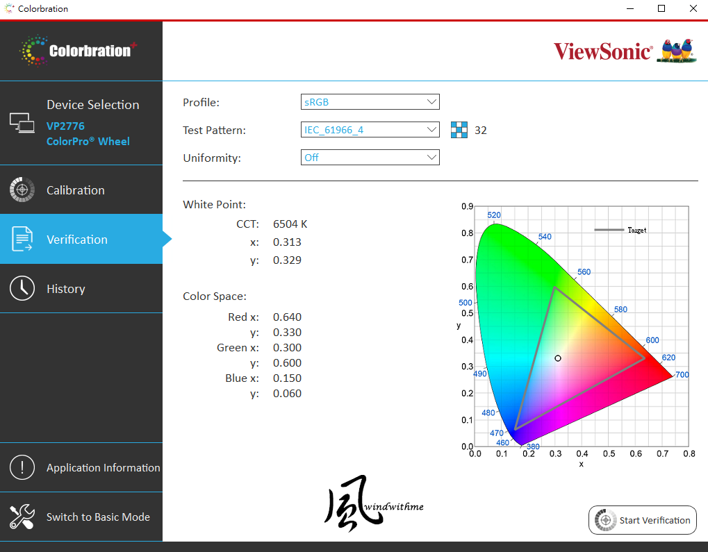

        The Verification page quickly verifies and reports on chosen color profiles.VP277620.thumb.png.ddc07e7f4ef3bd3ea37426bf45a543cc.png

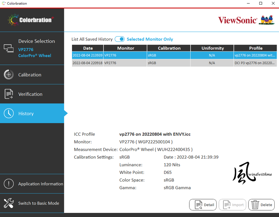

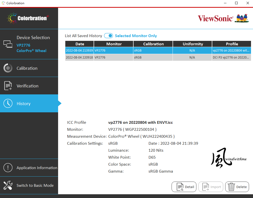

          History details previous color calibration profiles for comparison or application.VP277621.thumb.png.a79bffafa43781b98eacdd5d15cc37b9.png

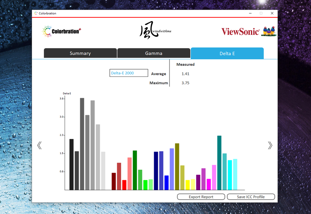

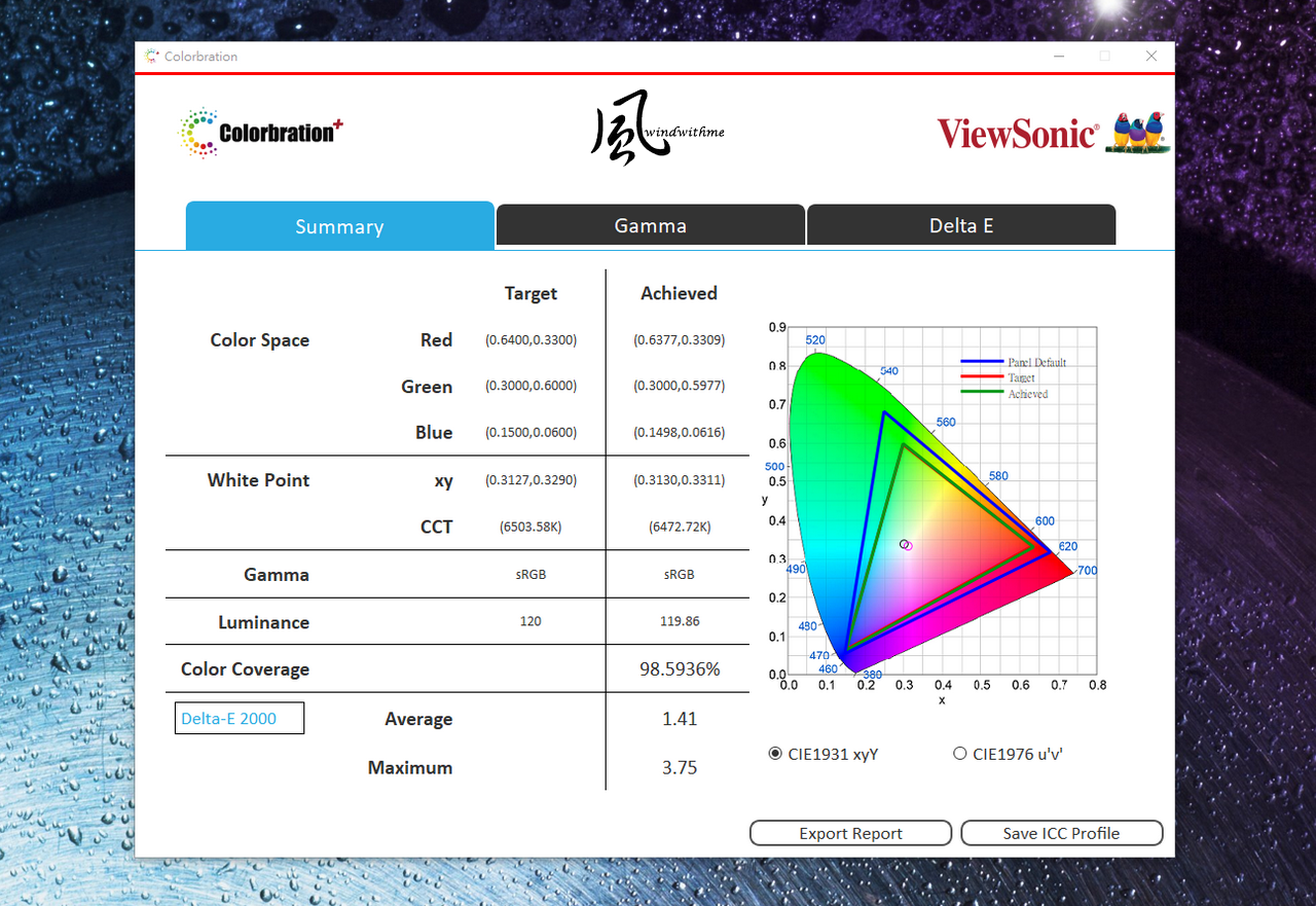

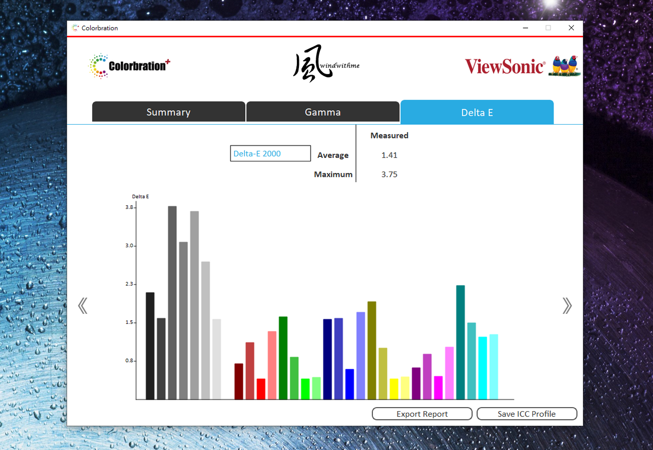

          The report’s Summary, Gamma, and Delta E tabs detail the color gamut and related info.VP277625.thumb.png.310031028387c6783c1d706f4a6b7c18.png
          The Delta E page presents the data recorded in the form of a bar graph. The VP2776 displays true-to-life colors at Delta E < 2, and has a Delta Lv < 5% standard that emphasizes professional color with greater precision.

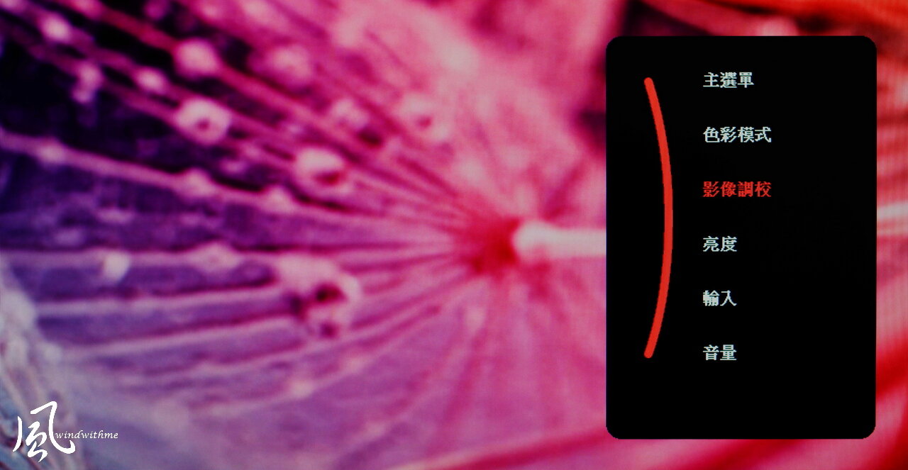

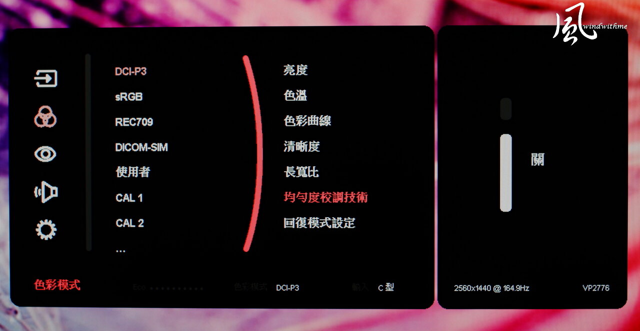

          A photograph of the OSD menu:
          Moiré patterns usually appear when LCD screens are photographed with digital cameras, although the monitor display appears normally to the naked eye.
          Quick Mode features options for Main Menu, Color Mode, ViewMode, Brightness, Input, and Volume. The curved line on the left indicates that the menu may be navigated by rotating the calibrator wheel.
          Color Mode has options for DCI-P3, sRGB, REC709, DICOM-SIM, User, CAL 1 to 3, and HDR.
          DCI-P3 provides options for Brightness, Color Temperature, Gamma, Sharpness, Aspect Ratio, Uniformity, and Recall.VP277628.thumb.JPG.2c7b9a0cd6b8ac7f5a4466c5b8f1c57f.JPG

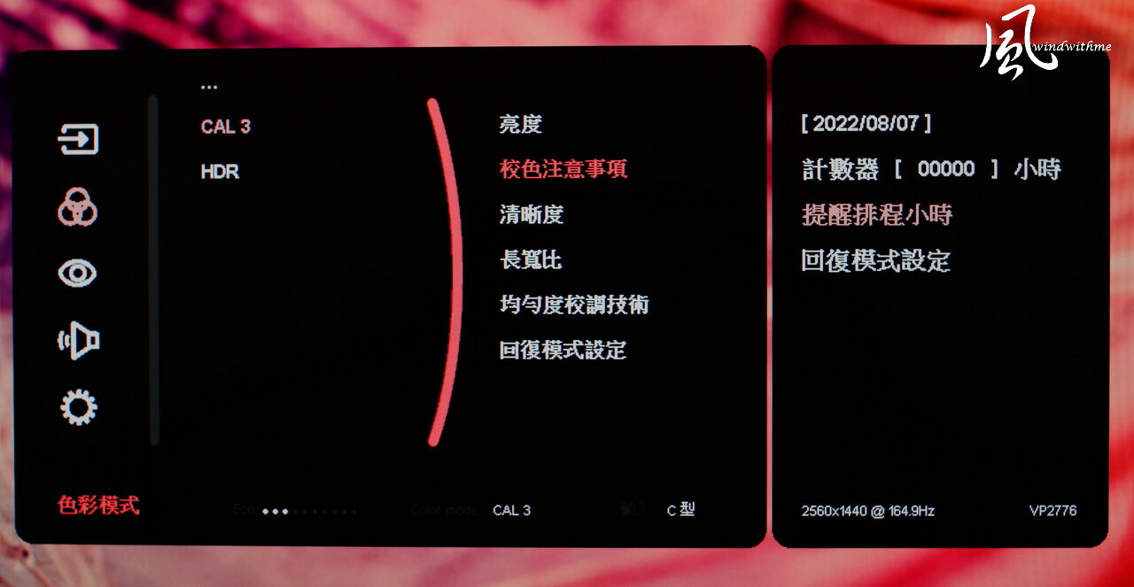

          Calibration profiles are stored in the CAL modes. The time at which a profile was created is recorded, along with a useful calculation of how long it has been in use. Reminders can be set at specified intervals to maintain accurate color calibration—the first time I’ve seen such a meticulous design detail. Using the calibrator wheel, profiles can be produced, imported into the OSD, and renamed.VP277629.thumb.JPG.6acdfb67d90bb3a69d7f586f68170465.JPG

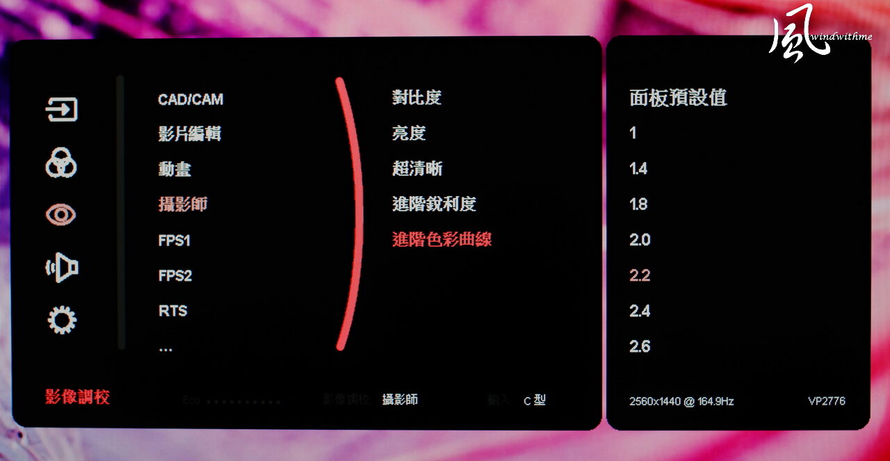

          ViewMode brings up options for CAD/CAM, Video Edit, Animation, Photographer, FPS1, FPS2, RTS, and MOBA modes. Select an environment, and detailed options appear for fine-tuning according to your needs. For example, Photographer mode has settings for Contrast, Brightness, Ultra Clear, Advanced-Sharpness, and Advanced-Gamma.VP277630.thumb.JPG.1ff2af9fafdd0356146afa5122f92a0c.JPG

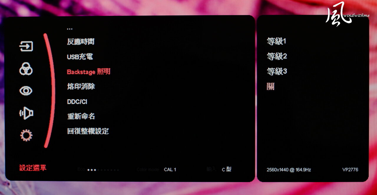

            The Setup Menu has three pages in total, with options for Language Select, Adaptive Sync, Resolution Notice, PureXP, Information, OSD Timeout, OSD Background, OSD Pivot, Power Indicator, Auto Power Off, Sleep, Multi-Picture, ECO Mode, Overscan, Response Time, USB Charging, Backstage Lighting, Burn-in Eraser, DDC/CI, Rename, and All Recall.
            The backlight on the rear of the monitor can be set to white, yellow, and warm white in Backstage Lighting. This is the first time I’ve seen a Burn-in Eraser function, too. The comprehensive OSD, together with the two exclusive software packages and integrated calibrator, provide rich options and a high degree of freedom in adjusting color.VP277631.thumb.JPG.5475da1494cf61daeeef3f4308068bb3.JPG

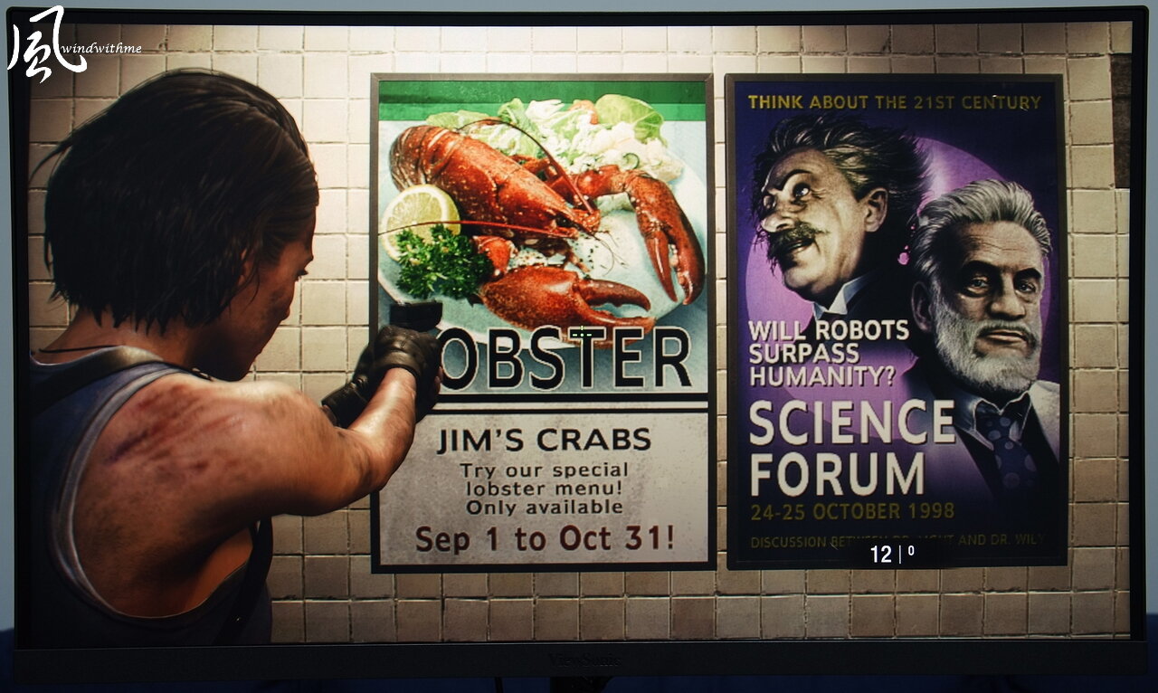

            HDR technology has become increasingly widespread in recent years, and whether or not a monitor supports it will be reflected in the price. When enabled, the details of an image’s blacks and bright areas are displayed to the full, enriching the colors. Whether to use HDR or not is one more advanced option to have when enjoying games or video that support it.

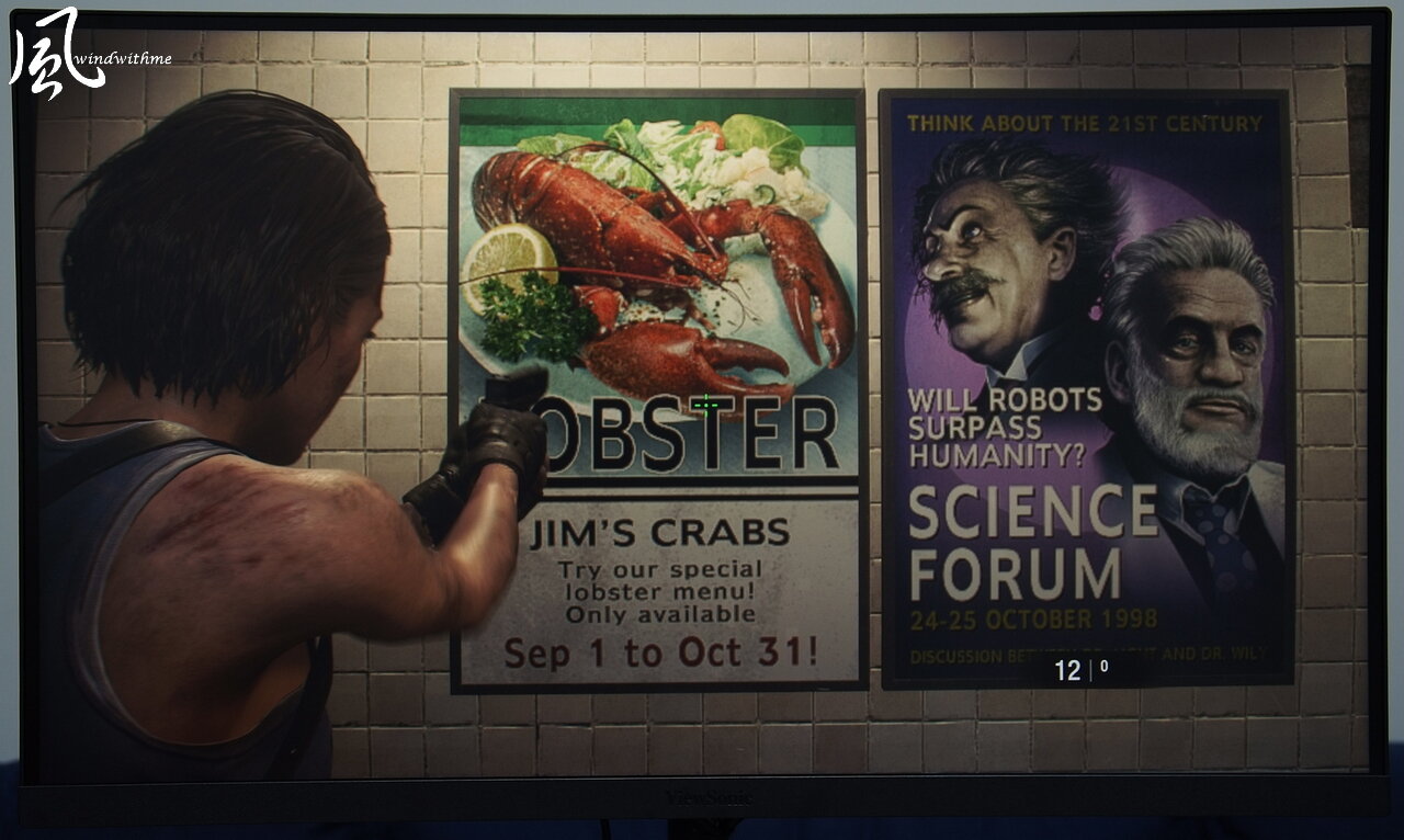

            HDR video is not easily compared, so I’m using a game to compare the differences—HDR off:VP277632.thumb.JPG.b6edb845a55f6e7614bcbfa2d8fb1863.JPG
            HDR set to Standard:
            Options for Standard, HDR_M (medium), and HDR_H (high) can be chosen from the OSD. I should note that image quality has deteriorated a little in each case after using a camera to photograph the screen. Actual picture quality ought to be judged with one’s own eyes. Turning on HDR does indeed improve the picture.VP277633.thumb.JPG.6d48d6c53dc7dbbbe9c14ecfe8b2e89a.JPG
